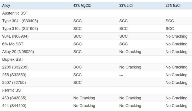

    Corrosion Testing
    The relative resistance of a stainless steel to chloride SCC is often quantified by the use of standard boiling salt solutions. The table attached summarizes the results of testing in boiling salt solutions of 26% NaCl (sodium chloride), 33% LiCl (lithium chloride), and 42% MgCl2 (magnesium chloride). The boiling LiCl and MgCl2 test solutions are very aggressive relative to practical applications and only austenitic alloys with compositions that approach those of nickel-base alloys will routinely resist cracking in these test solutions.
